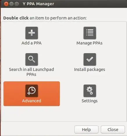

There is a software called as Y PPA manager It can help fix GPG keys errors.
Y PPA manager
To install -
sudo add-apt-repository ppa:webupd8team/y-ppa-manager
sudo apt-get update
sudo apt-get install y-ppa-manager

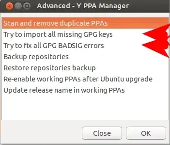

Once you install it start it ,then go to advance and select "import all missing GPG keys"

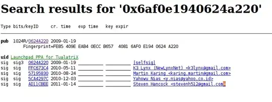

The automatic download using apt-key adv --recv-keys may not work behind a firewall.
In this case, open the webpage of Ubuntu Key Server in your web browser and search for the string 0x<hexadecimal code of your missing key>.

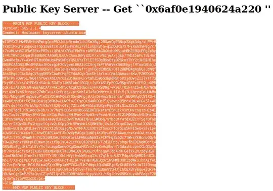

Open the link in the pub section. Save the key contents (from -----BEGIN PGP PUBLIC KEY BLOCK----- to -----END PGP PUBLIC KEY BLOCK-----) as a file.
Then run:
sudo apt-key add <file-with-saved-key>

The Most Easiest Way Is With Y PPA MAnager
sudo apt-get update

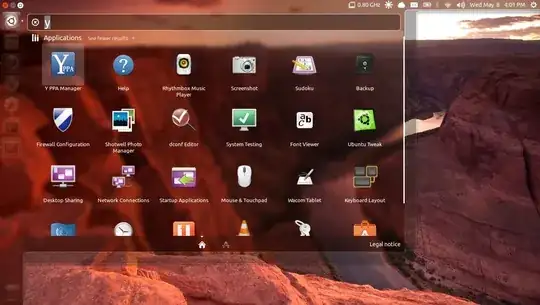

Open Y PPA Manager From Dash

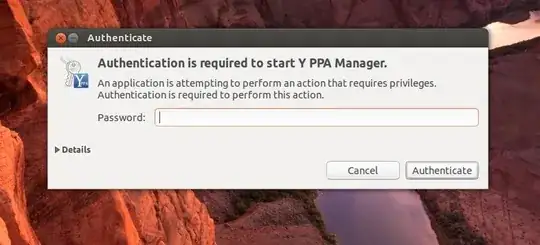

Enter Your Admin Password
Double Click On Advanced Option
Click Try To Import All Missing GPG Keys
Click Ok To Fix It
