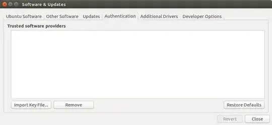

Another related problem that I see is that the Software and Updates app has no entries in the Authentication tab. Which leads me to believe it's an issue related to permissions.
I've checked permissions and compared with what I see is normal online, but can't see anything wrong.
