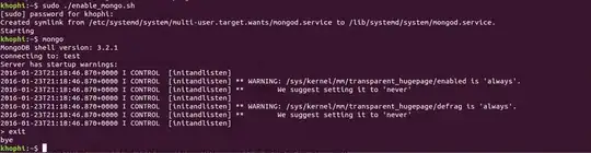

At the time of writing this, I had Mongo 3.2.1.
Working example. Mongo 3.2.1 on Ubuntu 15.10
