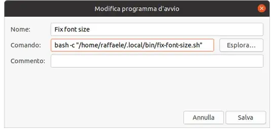

  1. Create a script (I put it in ~/.local/bin) with the following content:
    sleep 5s
    gsettings set org.gnome.desktop.interface text-scaling-factor 1.01
    sleep 0.5s
    gsettings set org.gnome.desktop.interface text-scaling-factor 1.00
    '1.01' it's just a number to trigger the changes, it may be any value. I decided to use a value very near to the final one. '1.00' is the value that I eventually want. Feel free to put your target value. Same thing for the sleep times, you can change them.
  2. Make it executable running:
    chmod +x ~/.local/bin/fix-font-size.sh
  3. Run the script (I named it fix-font-size.sh) at boot. For this reason I run Startup Applications Preferences app and created a new item with the following command:
    bash -c "/home/username/.local/bin/fix-font-size.sh"
    Also see the screenshot for reference (where "Modifica programma d'avvio" means "Startup Applications Preferences"):
    add command to startup applications
  4. Save and you should have a correct size font after login without manually inserting commands in the terminal or by GUI.

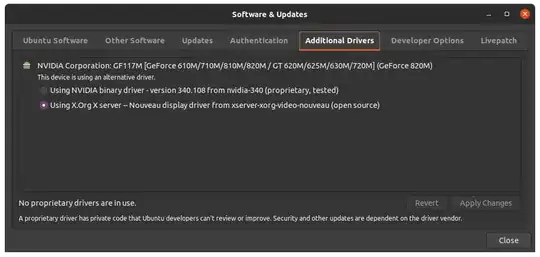

I installed Ubuntu 20.04 LTS yesterday and faced this exact same problem. This and whenever I close and re-open my laptop lid, the wallpaper gets corrupted, but that's a whole other question. After some messing around I figured out how to solve this issue. All you have to do is change the graphics driver from NVIDIA Binary Driver to X.Org X Server in the Additional Drivers section under Software & Updates (Remember to click Apply Changes, this will take a while). After the changes have been applied, restart your PC. Doing this fixed the issue and the other bug I mentioned above.
Cheers!
The method above is a permanent fix. If you want to use the NVIDIA driver, I think you're gonna have to wait for the developers to release a patch.

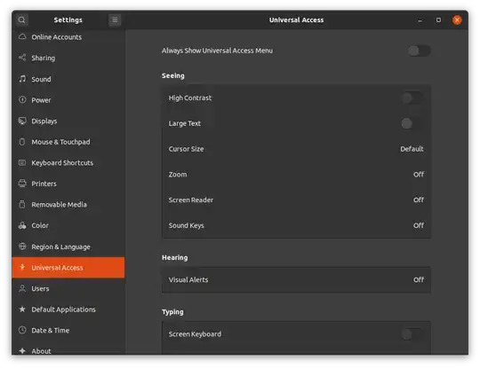

I also found this temporary fix (for the bug in question, not the one I mentioned above). You'll have to do this every time you restart. This is if you really wanna keep your NVIDIA driver.
Go to Settings>Universal Access and enable & disable Large Text. That'll show you how Ubuntu is supposed to look.
