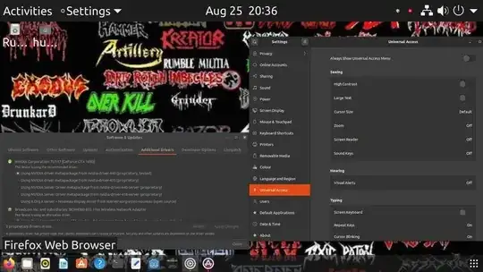

So, I had a few issues installing a fresh Ubuntu 20.04 with respect to the GPU driver. I was having issues with screen size, that were eventually fixed. Now, with a recent update, I have an initial start up and log on screen that is abnormally large. Once I am in the GUI I am faced with a screen with appropriately set sizes (as set in settings), except for text (as seen in the top ribbon in the image below):
Screenshot showing top ribbon
The large text option in the universal access is not turned on and, strangely, when it is turned on the text resizes back to normal. This isn't a massive problem, as this fixes the issue, but it is a hassle as it has to be done each startup. I suspect it is a driver issue but I don't know where to start. I am new to these forums so, please be kind and let me know what information you need to answer the question. It will be provided promptly.

So, for my machine, it seems that every startup script solution I have tried does not resize the text on the screen, on startup. The only solution that has worked for me has been taken from comment #17 at https://bugs.launchpad.net/ubuntu/+source/mutter/+bug/1892440 and involves downgrading the libmutter package to the state prior to the upgrade. The commands are as follows:
sudo apt install libmutter-6-0=3.36.1-3ubuntu3 gir1.2-mutter-6=3.36.1-3ubuntu3 sudo apt-mark hold libmutter-6-0
The first command reverts the package and the second command stops subsequent update events from updating the package. The second command is optional, but it means that you will manually either have to unselect this update or re-run the first command untill the problem is fixed with the package.
