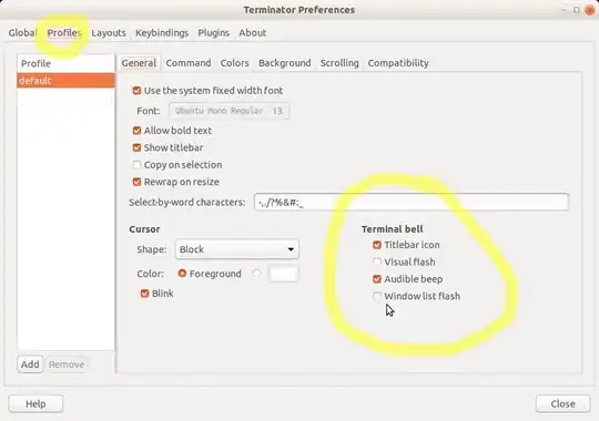

It turns out you just have to enable the setting! (It comes disabled by default).
Right-click on the terminator screen --> Preferences --> click the "Profiles" tab at the top --> ensure the "General" sub-tab is chosen --> check the box for "Audible beep" under the "Terminal bell" section in the bottom-right:
That's it! Works perfectly now--same as in gnome-terminal, even over ssh:
echo -e "\a"
