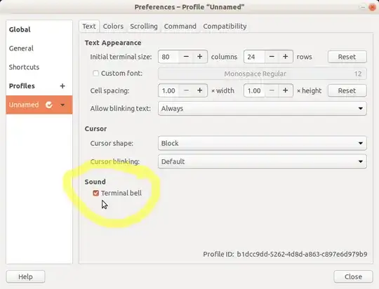

Today, June 2020, in Ubuntu 18.04, the whole sudo modprobe pcspkr and commenting out of the blacklist pcspkr part of the /etc/modprobe.d/blacklist.conf file, as described here, doesn't seem to be necessary.
Mine is still blacklisted, yet my bell character sound works just fine!
$cat /etc/modprobe.d/blacklist.conf
# ugly and loud noise, getting on everyone's nerves; this should be done by a
# nice pulseaudio bing (Ubuntu: #77010)
blacklist pcspkr
Instead, just make sure the Terminal bell sound is turned ON in your gnome-terminal settings:
Right-click on the screen in gnome-terminal --> Preferences --> check the box for "Terminal bell" under the "Sound" section, as shown below:
Now run this, and hear the dull "thud" sound of the bell character sound:
echo -e "\a"
This also works over remote ssh sessions, which is super handy when building on a remote machine, for instance, so that it will play the bell sound when the build is done, to alert you:
time bazel build //...; echo -e "\a"
Also note that pressing Backspace when there's nothing to delete will also play this sound in gnome-terminal.
