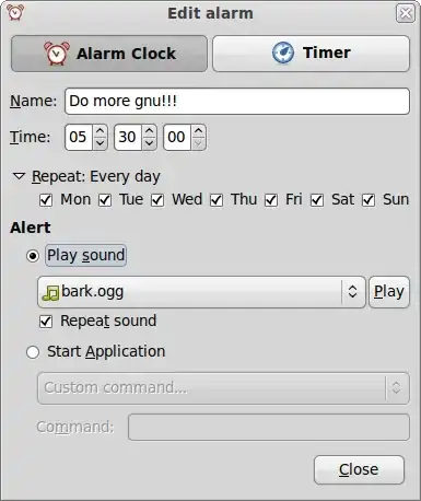

Alarm Clock is a fully-featured alarm clock which resides in the notification area. It is easy to use yet powerful with support for multiple and repeatable alarms, as well as snoozing and a flexible notification system.
Two types of alarms are supported: Alarm Clocks and Timers. Notification is done by either playing a sound or launching an application.
This software is not available in the official repositories. The developers recommend using their official PPA.
sudo add-apt-repository ppa:tatokis/alarm-clock-applet
sudo apt update
sudo apt install alarm-clock-applet

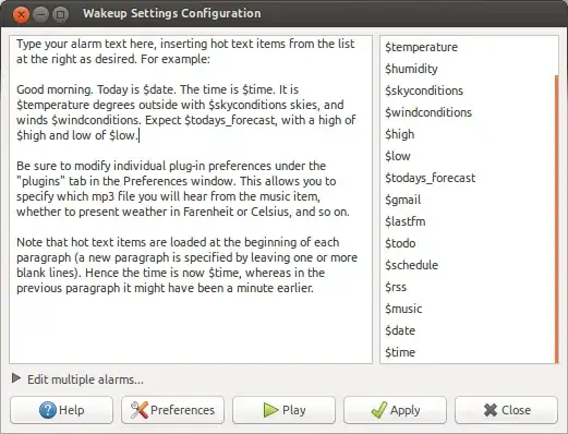

https://apps.ubuntu.com/cat/applications/wakeup/
This package has a complete graphical front end with which a user can set an alarm to wake the computer - from poweroff if possible - and read a user-defined text. This text can grab relevant information (date, time, weather, Evolution schedule and tasks, news from an rss feed, number of new email messages, etc.) and speak that as well, or play music, all as defined by the user. More capabilities can be added to the alarm via a complete and simple plugin system. Supports multiple alarms.
Install via the software center

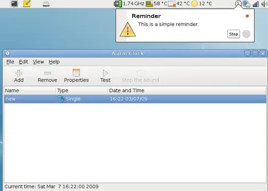

https://apps.ubuntu.com/cat/applications/alarm-clock/
Alarm Clock is the personal alarm clock for GTK+ desktop environments. It supports sound fading, scheduled alarms, snooze option, passive window reminders, exception lists for scheduled alarms, exporting alarms and much more!

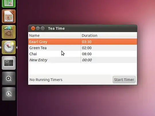

You might want to have a look at Teatime:

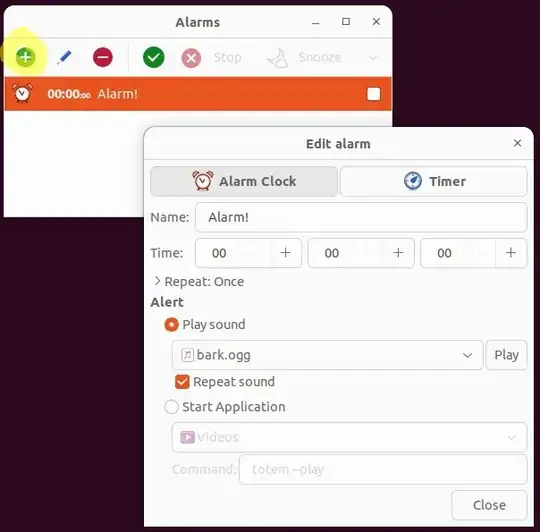

Press Windows --> type "alarm" --> click the "Alarm Clock" icon. Then, click the "+" button in the top-left of the app, and create an alarm, as shown below!
Use the "Alarm Clock" mode to set an alarm to go off at a certain time of day (using a 24-hour clock), and use the "Timer" mode to have a countdown timer that goes off once the specified time has elapsed (up to 23h:59m:59sec):
The sound appears to play indefinitely until you stop the alarm or timer, which is great. (Note: my command-line alarm_timer script below does that too.)

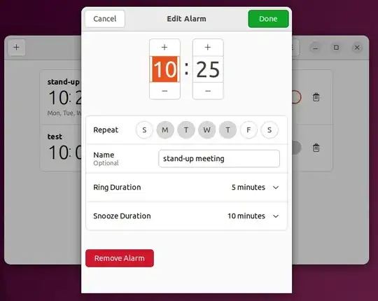

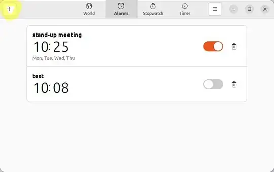

2. Gnome Clocks
Gnome Clocks has a good (and annoying) alarm. It sounds just like a loud watch alarm, or old alarm clock high-pitched "beep beep". You can set the alarm duration (default is 5 minutes), and snoose it.
Install it:
sudo apt update
sudo apt install gnome-clocks
Then open it by pressing the Windows key and typing "Clocks". Click the icon to open it.
Here are some example alarms. Click the + in the top-left to add a new alarm:
Here are some alarm settings: enter image description here

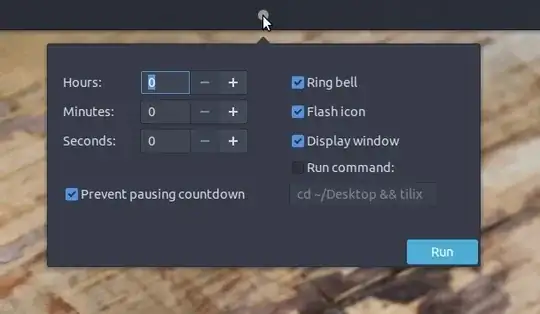

For Ubuntu Budgie
Budgie CountDown
The icon changes color on time progress, from green to yellow - red.
Installation
  • For 16.04 - 17.10:
    Activate backports:
    sudo add-apt-repository ppa:ubuntubudgie/backports
    and run:
    sudo apt install budgie-countdown-applet
  • For 18.04 and higher, it will be in the repos.
