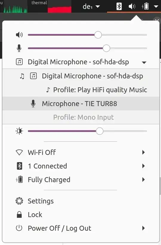

I can strongly recommend the Sound Input & Output Device Chooser GNOME Shell extension. It allows very easy and quick device switching (both input and output). Some screenshots:
drop-down
properties

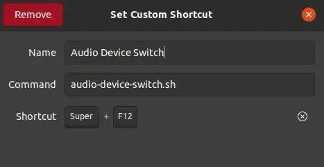

  6. Create a shortcut from the Settings providing the following config:
    shortcut dialog
