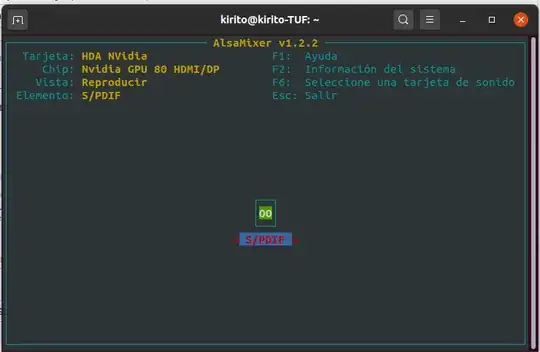

Installed Ubuntu 20.04 and I do not have sound.
I already tried many ways to solve it but the problem persists. When i run alsa mixer this comes out.
alsa mixer

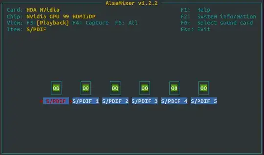

I have tried every answer about this problem on stackoverflow but no one worked.
This is the solution that worked for me:
sudo apt-get update -y
sudo apt-get install -y gnome-alsamixer
alsamixer

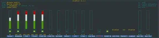

Press F6 and find your sound card
By default I have HDA NVidia selected; but Chip is not match with my sound card. HDA NVidia Selected Card Alsamixer If I press F6 and choose another one I will see my Sound Card name after Chip: HD-Audio Generec We have to navigate to the Auto-Mute option by using Left/Right Arrow-Keys and then disable it by using Up/Down arrow key.
Note: This solution worked for me but may not work for you. Try all solutions you see until you repair your sound :)
