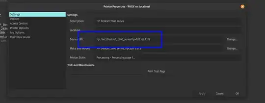

I don't know what happened here, but honestly I also agree some TLC is needed for printer setup in 20.04, ( 18.04 i was able to plug it in via USB and it just worked )
I was able to get it working by pressing the wifi button on the printer ( HP Deskjet 2652 ) ... while the printer was plugged in via USB
The button looked like this ( blue LED light to the left of the button )
printer wifi button

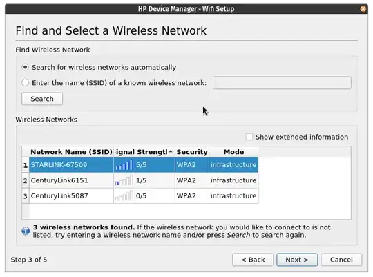

After I pressed the button, the printer printed off some not-so-helpful help pages. I then noticed the rest of the options appeared ( print, scan, print test page, align, and wifi setup using usb ), previously i was not able to see them.
Notes on how to open the hp toolbox
sudo apt install hplip hplip-gui
hp-systray -x
#open the device manager from the running service icon in the systray

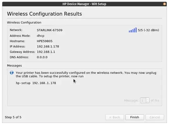

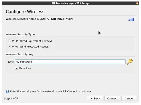

I then followed the steps to setup wifi over usb.
The blue wifi light started blinking, I completed the wifi setup using WAP, entered my wifi password, and the blue wifi light on the printer stopped blinking and went solid.
and somehow automagically it started printing after I ran hp-setup 192.168.1.178 ( which the usb wifi setup said to run )
Previously when I ran sudo ippfind ; sudo driverless ; sudo hp-scan -g no results were given. After, the wifi print setup it gave me the following.

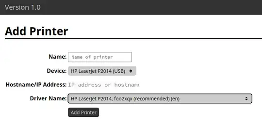

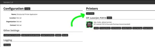

Start using ghostscript-printer-app from snap store!

Step by step solution
1. Install ghostscript-printer-app from snap store
sudo snap install ghostscript-printer-app --edge
2. Setup printer
  1. Go to http://localhost:8000 > Add printer enter image description here
  2. Specify Device and Driver Name corresponding to your printer model > Add printer enter image description here
