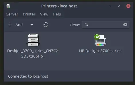

I've tried hp-setup, paged through the setup and it reported that everything is fine. In the Printers I see my printer with a green checkmark.
printer settings 1

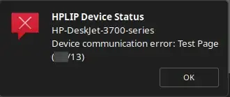

But when I want to print a test page, it says this:
Device communication error
I also get notifications like this:
Printer 'HP-DeskJet-3700-series' may not be connected.
Finally, when I try to print, I see the print job in the queue of the printer, but nothing happens. No blinking lights on the printer, no error code, nothing. The printer is just there as if nothing is happening. All cables connected, turned, paper fed into it, door open, cartridges are full of ink.
How do I get it to print that 2nd page, and why was it able to print the 1st one?
error notification 1
error notification 2

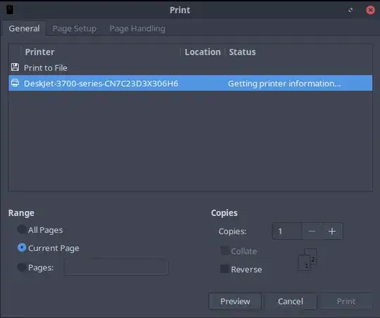

If I delete the printer from Printers, I still see a printer when I try to print a page, but the info that populates in the description is "Getting printer information", which never ends.
print dialog

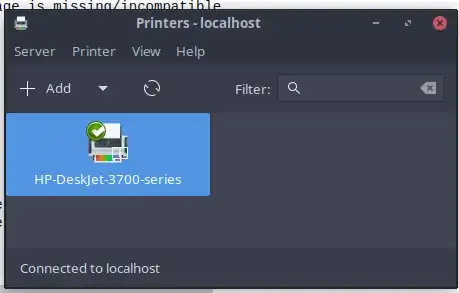

There's is more to that strange "shadow" printer that ends in an underscore. If I try to delete it, it just adds itself back to Printers.
printer settings 2
