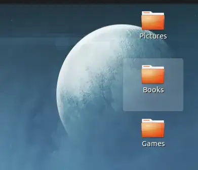

I've just upgraded from Ubuntu 18.04 to its newest LTS version - 20.04. While it comes with some interesting changes, the Desktop icon system was messed up in my opinion. When you hover the mouse cursor over the icons, you see a huge space marked around them that cannot be violated (as you can see in the image below) so that they need to be placed very far apart from each other.
18.04 allowed you to place icons much closer to each other and didn't have that marked space around them. This new way leaves much less space on the Desktop to organize large amounts of icons - including folders, files and shortcuts. Is there a way I can significantly reduce the size of icons and their "spaces" or go back to the old system of organizing files? On "Settings", there is a tool to change the size of Dock icons, but not of Desktop icons.

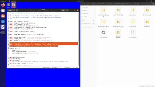

Original Content:
const ICON_SIZE = { 'small': 48, 'standard': 64, 'large': 96 };
const ICON_WIDTH = { 'small': 108, 'standard': 116, 'large': 116 };
const ICON_HEIGHT = { 'small': 86, 'standard': 102, 'large': 134 };
Edited Content:
const ICON_WIDTH = { 'small': 52, 'standard': 116, 'large': 116 };
const ICON_HEIGHT = { 'small': 60, 'standard': 102, 'large': 134 };
I Have Configured the sizes for 'small', you can achieve with other sizes 'standard' and 'large' also.

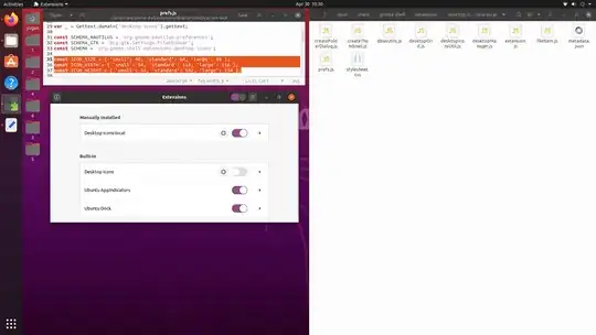

Above method requires root privileges.. If you need to make changes locally..
Disable the system extension desktop-icons.
gnome-extensions disable desktop-icons@csoriano
create the local extensions directory.
install -d $HOME/.local/share/gnome-shell/extensions
Copy the system extension desktop-icons to local extensions directory and rename it as desktop-icons@csoriano-local
cp -r /usr/share/gnome-shell/extensions/desktop-icons@csoriano $HOME/.local/share/gnome-shell/extensions/desktop-icons@csoriano-local
Edit the metadata.json file of the local extension like below contents. Observe that "local" is the main change
{ we need to edit the metadata.json file because extensions directory name and the UUID field in the metadata.json file must match }
gedit $HOME/.local/share/gnome-shell/extensions/desktop-icons@csoriano-local/metadata.json
Already Edited Content:
    "name": "Desktop Icons-local",
    "description": "Add icons to the desktop",
    "uuid": "desktop-icons@csoriano-local",
    "shell-version": ["3.34.0"]
Enable the local extension with below command
gnome-extensions enable desktop-icons@csoriano-local
Refresh the gnome-shell with Alt+F2 'r' Enter method.
Make sure you never turn on both the extensions desktop-icons@csoriano (System Extension) and desktop-icons@csoriano-local (Local Extension)

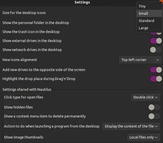

For Ubuntu 21.04 you can change the size of the desktop icons by simply adjusting it via the desktop settings again.
Right click on the desktop->choose settings You can adjust the Icon size in the Dialog
