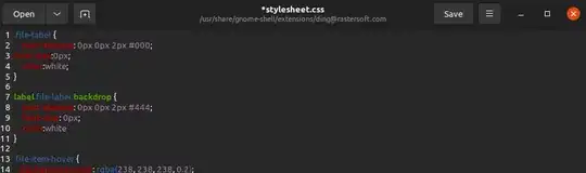

Okay i ended up installing this extension Desktop Icons
and after installing I disabled the extension (it doubled my icons for some reason)
then i went into /usr/share/gnome-shell/extensions/ding@rastersoft.com/stylesheet.css and added font-size:0px; in line 2 and line 9 it now looks like this.
and my desktop icons look like this enter image description here
Thanks for the support yall!
