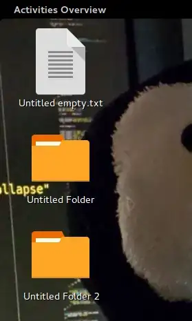

I am still unable to do the same for the desktop while not in Nautilus so icons look like this:
So that is really my question, without putting these icons on a diet, how do I shrink them down to normal size like they were in Gnome 3.14 and like I achieved in my other question?

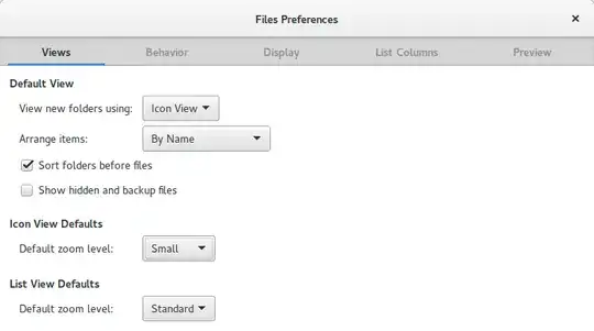

The icon size settings for the desktop are the same as for the icon size in Nautilus for Icon View Defaults.
For smaller or bigger sizes, use the next steps

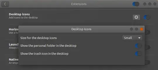

As of Gnome 3.36, the default way to change the Desktop icons size is through the Gnome Extensions settings for Desktop Icons. There are only three options: Small, Standard and Large, with Small meaning an icon of size 48 px inside a 120 px by 98 px padded box.
Gnome Extensions
This can be changed by editing the file located at
/usr/share/gnome-shell/extensions/desktop-icons@csoriano/prefs.js
and changing the values of ICON_SIZE, ICON_WIDTH and ICON_HEIGHT.
After you have saved your changes, restart the Gnome shell by pressing Alt+F2 and then running r at the prompt. This should immediately have visible effects on your desktop icons.
