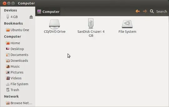

At the top of a blank desktop or you home folder go to the menu and hover over the "Go" a menu will pop up, click on "Computer" on that you will see something similar to this
Instead of my USB drive you will see a icon that looks like the File System icon that will say (size of your hard drive)GB File System(example-500GB File System) This is your hard drive if you click on it you will mount your Windows partition and you will be able to access the files, your personal files are in the "Users" folder under your username.
F.Y.I. the "File System" you see on my screen shot is the Ubuntu File System(also seen on the left side bar under Computer)
Oops, forgot to add that you can then move the files from one partition to the other, it will be easier if you open two windows and you can then drag from one to the other, easier than trying to drag between tabs I think.
Note: thank you to Linux Distance for the correction on the Windows folder for Windows 7, I only used Windows 7 for long enough to check that all the hardware on my new computer were working(about 2 days) then wiped Windows and installed Ubuntu so I was erroneously giving the folder for Win XP as my memory was faulty.
