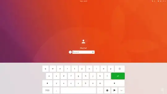

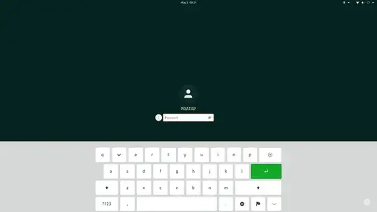

there are four options
background with image
background with color
background with gradient horizontal ( requires two valid hex color inputs)
background with gradient vertical ( requires two valid hex color inputs)
tip: be ready with valid hex color code in place of below example like #aAbBcC or #dDeEfF. Change them to your preferred hex color codes. you may choose colors from https://www.color-hex.com/
Example Commands:
sudo ./ubuntu-gdm-set-background --image /home/user/backgrounds/image.jpg
sudo ./ubuntu-gdm-set-background --color \#aAbBcC
sudo ./ubuntu-gdm-set-background --gradient horizontal \#aAbBcC \#dDeEfF
sudo ./ubuntu-gdm-set-background --gradient vertical \#aAbBcC \#dDeEfF
sudo ./ubuntu-gdm-set-background --reset
./ubuntu-gdm-set-background --help
try Ctrl+Alt+F1 to go the gdm screen to see the change.
