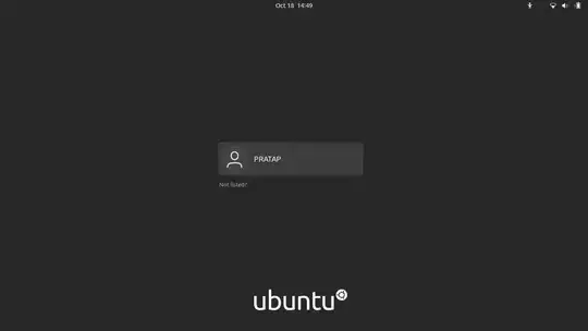

How to Change Ubuntu 21.10 gdm background to a Image or to a Color.
Below Pic is of Ubuntu 20.04 GDM Login Screen

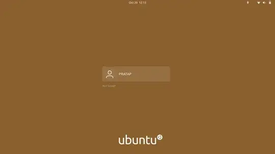

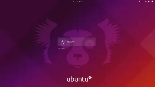

For Changing the GDM Login Screen Background with a Image, Color or Gradient Horizontal or Vertical. There is a script in github. https://github.com/PRATAP-KUMAR/ubuntu-gdm-set-background.
You can download the script with the below command
wget -qO - https://github.com/PRATAP-KUMAR/ubuntu-gdm-set-background/archive/main.tar.gz | tar zx --strip-components=1 ubuntu-gdm-set-background-main/ubuntu-gdm-set-background
Once the script is downloaded, you can read the help with below command
./ubuntu-gdm-set-background --help

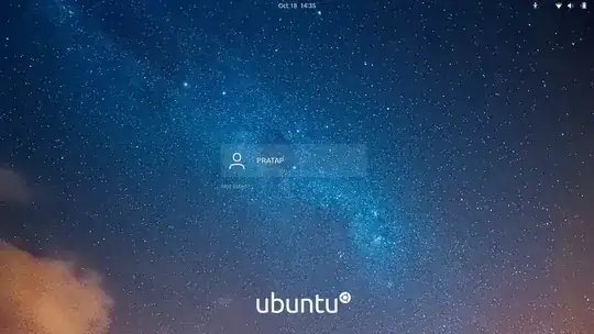

to set the background as image, run the below command. Replace the path of the image to your preferred one.
sudo ./ubuntu-gdm-set-background --image /home/user/backgrounds/image.jpg

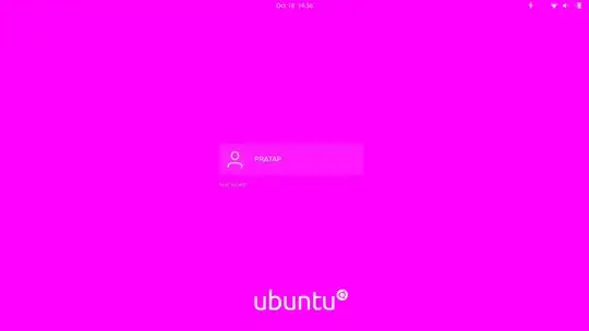

to set the background as color, run the below command. Replace the Hex Color Code with your preferred one.
sudo ./ubuntu-gdm-set-background --color \#aAbBcC

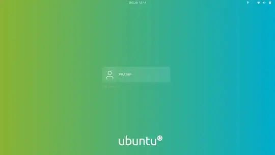

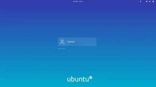

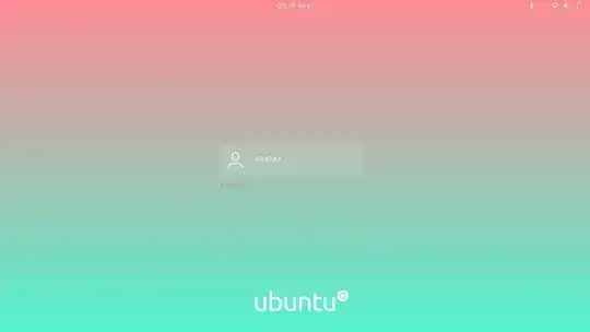

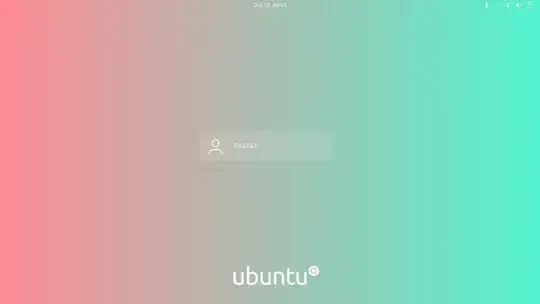

to set the background as gradient's horizontal or vertical. Run the below command with either horizontal or vertical as choice and by replacing the two Hex color codes as you wish
sudo ./ubuntu-gdm-set-background --gradient horizontal \#aAbBcC \#dDeEfF
