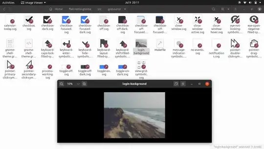

I have gone through the source code of flat-remix https://drasite.com/flat-remix-gnome

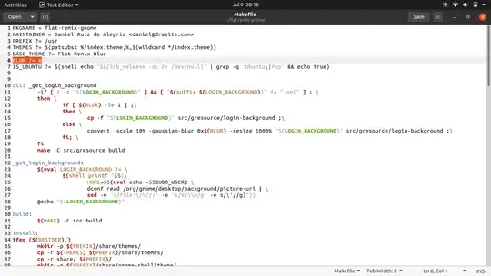

The better way is to reinstall the package again after replacing the background image from source and making the blur value to suitable value..
git clone https://github.com/daniruiz/flat-remix-gnome
cd flat-remix-gnome make && sudo make install
PKGNAME = flat-remix-gnome
MAINTAINER = Daniel Ruiz de Alegría <daniel@drasite.com>
PREFIX ?= /usr
THEMES ?= $(patsubst %/index.theme,%,$(wildcard */index.theme))
BASE_THEME ?= Flat-Remix-Blue
BLUR ?= 6
IS_UBUNTU ?= $(shell echo "$$(lsb_release -si 2> /dev/null)" | grep -q 'Ubuntu\|Pop' && echo true)
