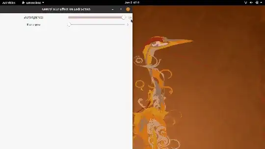

There is a Extension called Control Blur Effect on Lock Screen..
Control Blur Effect - Gnome Shell Extension
By default the Settings of the Extension make the Blur Sigma Value to 0, This means you can see the wallpaper without any Blur Effect.
Optionally you can Control this value and Brightness value too from the Extension Settings..
