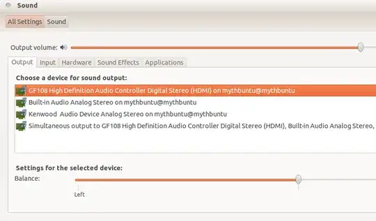

Here are my sound device output settings. As far as I can tell, all four devices point to the exact same physical device.
sound settings

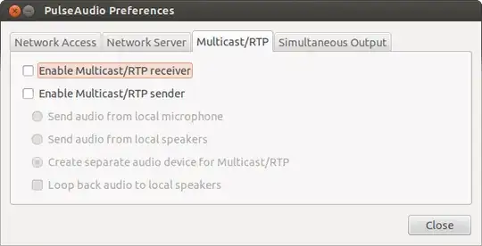

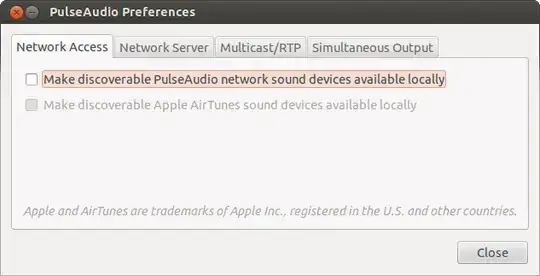

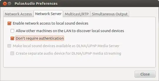

  2. On the server machine (i.e., the one with the speakers), start PA Preferences (paprefs) and set it up as follows:
    enter image description here enter image description here enter image description here enter image description here

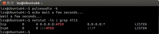

    • Then close it, and kill PulseAudio in a terminal as shown, wait, and check that it is now listening on port 4713:
    • If you don't see it, open paprefs again and check the remaining boxes in the Network Access and Network Server tabs (they don't hurt)
