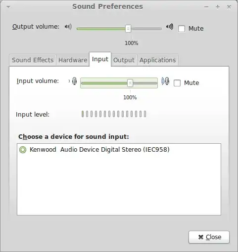

I have Buffalo headset with microphone that I know works fine becaue I routinely use it on a Windows 7 computer.
It connects to my Ubuntu 13.10 computer fine:
Bluetoth connected
But when I open sound preferences, there is no sound device related to the Buffalo headset (The kenwood is just a USB speaker system):

Usually this problem is caused because the headset is configured to use the A2DP profile, which is only one-way (but better quality), so your headset is functioning as a headphone.
You have to switch it to HSP/HFP profile. In the sound settings look under the Output tab, there you will find your headset, and change the profile to Telephony Duplex (HSP/HFP).
But after we did a chat conversation with Dave M G it turned out that his problem was coming from a special network configuration of his pulseaudio services: which is that his sound applications (music players, sound settings, pavucontrol, stc.) were talking directly to the remote pulseaudio server. But the bluetooth daemon on his PC didn't follow suit, it didn't talked to the remote one, instead it tried to connect to the local PA server, which was non existent that time.
When we launched a local PA server in verbose mode it clearly showed that the bluetooth daemon is connecting to the local server, but because every other sound application connected to the remote server there was no sound sent to the local server to hear from the bluetooth headset, and also the BT-headset didn't show up in the sound settings dialogs, because those applications were also manipulating the remote server. After tracing down the problem, Dave M G decided and managed to reconfigure his sound network setup and solve the issue.
