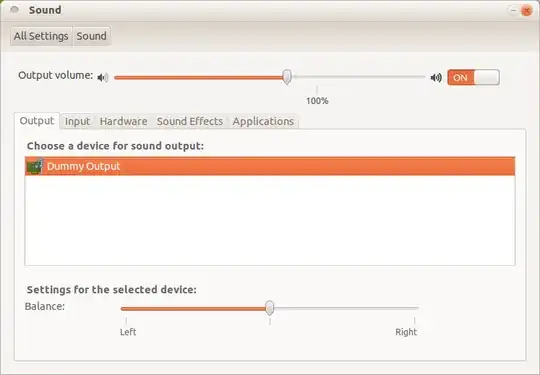

When I look at my sound settings, this is all I get:

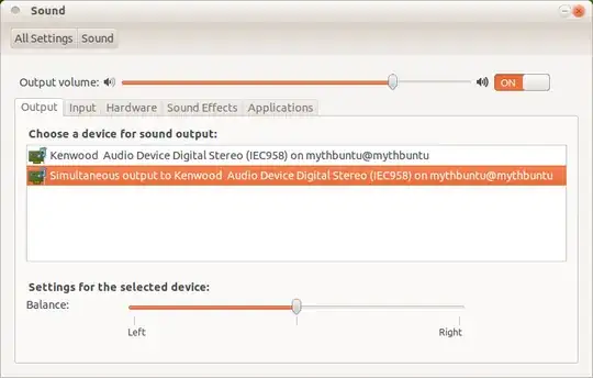

This is what my sound settings were before:

Turns out the problem was that the server, when rebooting, was not completely logging in automatically to the right user account.
I was not aware of this, but apparently for the Pulseaudio server to become available on the network, the right user has to be logged in on the server. I would have thought for the machine to be on would be enough.
Anyway, this has been resolved by ensuring the server is logged in to the correct user account after each reboot.
