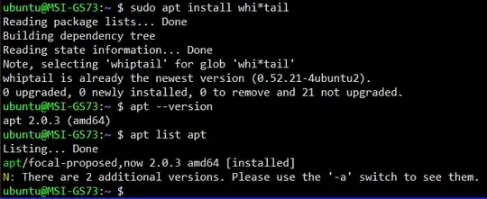

Per the changelog of apt, version 2.1.0:
* Reinstate * wildcards (Closes: #953531) (LP: #1872200)
(Link: Launchpad #1872200)
The asterisk (and only asterisk) has been restored for all apt subcommands, including apt install.
While 2.1.0 is too new to be shipped to Focal, it's been backported to 2.0.3 which is available in the focal-proposed repository. You can refer to the Ubuntu Wiki for enabling the Proposed repository, and then you can install apt 2.0.3 which has this feature backported.
See for yourself:
Note: You may want to read What is the "proposed" repository? before proceeding with the Proposed repository.
