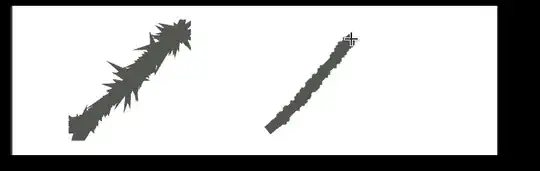

Background:
On Ubuntu 20.04 LTS, using the stylus with the freehand annotation tool results in jagged lines, as this post on reddit and this gif show. See also this thread on the bugtracker which suggests a modification to ./ui/pageviewannotator.cpp that has (I think) already been implemented in the cloned github version (search the thread for PageViewAnnotator). The TLDR of the problem is that when using the stylus, too many points are created that result in the jagged shapes when rendered.
okular freehand tool
Screenshot of the linked gif: stylus (left) vs. finger (right). Using a thick stroke here to highlight the issue. The stylus works fine in other programs like Xournal++.
