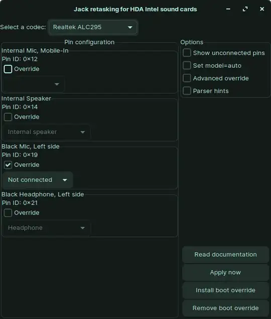

sudo apt install alsa-tools-gui
hdajackretask
Select the appropriate sound card up top in Select a codec:
Then make the Black Mic (headphone jack) override Not connected
Lower right corner, select Install boot override
Image showing how
Then reboot and test

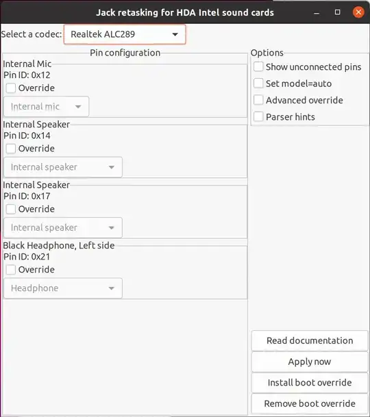

I solved this problem in a quite amusing way. I used hdajackretask to tweak some settings and found that leave the settings on the page as default and press Install boot override (and reboot) solved my problem.
A screenshot of the settings I installed:
