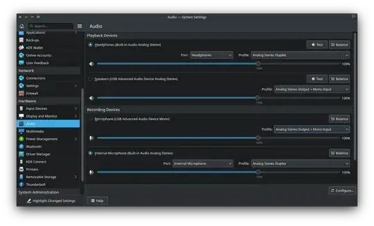

If you are on a laptop trying to use the built-in mic, make sure that you selected the built-in mic with the correct profile and port.
Things to check
  1. Open "System Settings" and select "Audio". Kubuntu System Settings for Audio
  2. If there are no recording devices, make sure that the profile for the built-in playback device (Built-in Audio Analog Stereo in this case) has the correct profile selected which is "Analog Stereo Duplex" in this case. If "Analog Stereo Output" is selected instead, the input will not show up.
  3. Check that the correct recording device is selected (Built-in Audio Analog Stereo in this case). The profile should be identical to the profile of the related playback device.
  4. Make sure you selected the correct port. "Internal Microphone" if you would like to use the built-in mic or "Headset" if you plugged in a headset.
