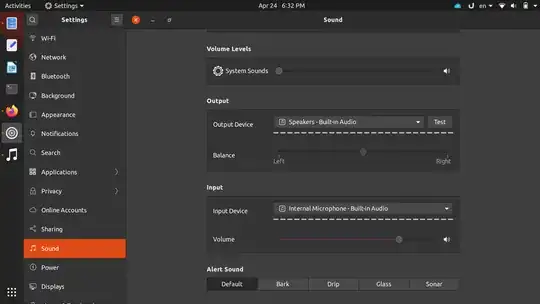

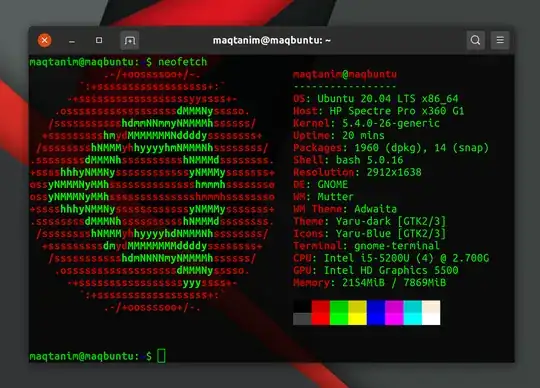

Here is my laptop configuration: enter image description here Here is the configuration of Settings > Sound enter image description here
