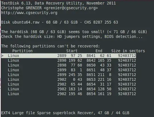

After creating the raw file, I run testdisk with Deeper Search, I get a list like this: enter image description here
Ater Deeper Search has finished, I get a list like this:
But I don't know which one is which snapshot... Any ideas?

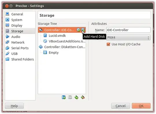

In case the broken VDI drive image is still registered with Virtual Box we may be able to add this image as a drive to our new virtual machine:
Start your virtual Ubuntu to which we had added the broken .vdi but do not mount the drive.

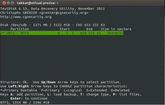

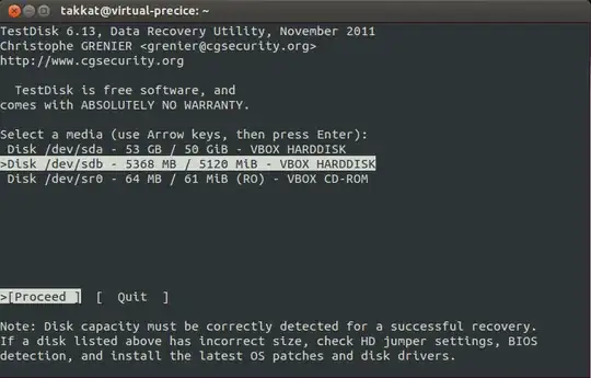

  4. Choose the appropriate drive to harvest data from (here shown for /sdb) and select [Proceed]
  5. Choose the appropriate partition layout (usually Intel)
  6. Select [Analyse] - [Quick Search]
  7. Select the partition which contains the data to harvest (here only a single NTFS partition was present):

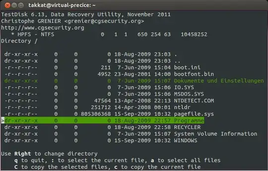

  8. Press P to list files on that partiton.
  9. Browse to the directory containing the data. View the filenames to make sure you did choose the right ones.
  10. Select directories or files to harvest using : . All selected files/directories will be marked green:
  11. Press upper case C to copy all selected directories/files to the rescue directory which will be selected in the next step.
  12. Choose a directory on your Ubuntu VM's mounted partition(s) to hold rescued data:
  13. Press c to start copying the data from the broken .vdi to our rescue directory in your healthy VM.

  • In case we can not see our files with the [Quick Search] option in 6. we may have to perform a [Deeper Search]. This will also list previous deleted and overwritten partitions. So we need to make sure we select the appropriate partitions where our data reside.

  • In case our rescue Ubuntu is too small to hold the rescued data we may create another new virtual drive to bind to the VM. This drive then has to be mounted in the VM to be able to save data from testdisk there.
