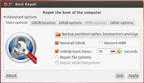

Install Boot-Repair in Ubuntu
  1. Boot your computer on a Ubuntu live-CD or live-USB.
  2. Choose "Try Ubuntu"
  3. Connect internet
  4. Open a new Terminal (Ctrl+Alt+T), then type:
    sudo add-apt-repository ppa:yannubuntu/boot-repair && sudo apt-get update
  5. Press Enter.
  6. Then type:
    sudo apt-get install -y boot-repair && boot-repair
  7. Press Enter.
Using Boot-Repair
Recommended repair
  1. Launch Boot-Repair from either :
    a. The Dash (the Ubuntu logo at the top-left of the screen)
    b. Or System->Administration->Boot-Repair menu (Ubuntu 10.04 only)
    c. Or by typing 'boot-repair' in a terminal
  2. Then click the "Recommended repair" button. When repair is finished, note the URL (paste.ubuntu.com/XXXXX) that appeared on a paper, then reboot and check if you recovered access to your OSs.
  3. If the repair did not succeed, indicate the URL to people who help you by email or forum.
