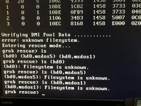

When booting I get the following error:
error: unknown filesystem.
I tried to find the filesystem with the following but did not find it.
ls filesystem is unknown

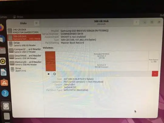

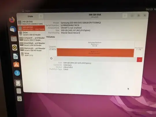

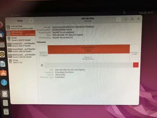

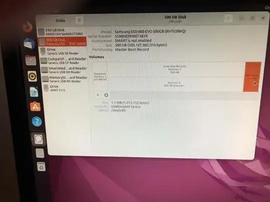

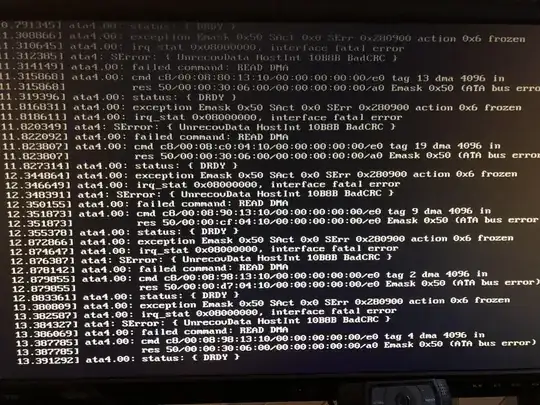

Taking the advice from @carles-mateo I installed ubuntu on a separate hard drive. I connected the Samsung 860 EVO 500 GB SSD to the new system on bootup I get the following when the hard drive is connected:
The new system starts up and I can view the disk from the Disks app. Here are all the partitions:
First:
First
Second:
Second
Fifth:
Fifth
Free Space:
Free Space

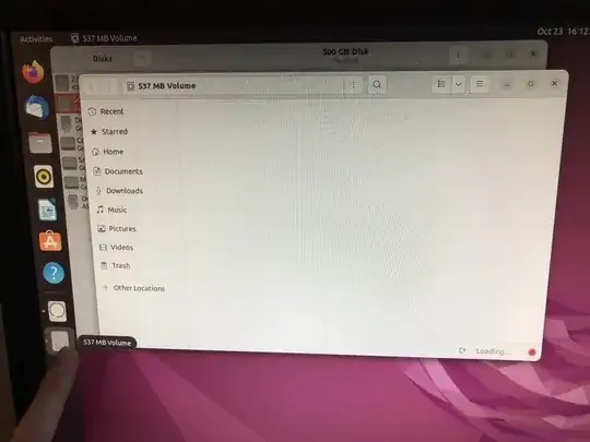

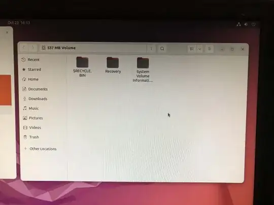

It seems that the First partition can be mounted and opened:
mount 1
It take a moment to load but here is what I see:
mount 2
