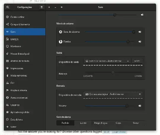

I had a similar problem on Ubuntu 20.04. I solved it by going to "Settings > Sound" and checking every device until I found one that worked. I choose one by one from the "Input device" checkbox until I could see the bar below flickering when I made sounds: An animated GIF where the GNOME's "Sound" settings show a chosen microphone not working. Then I change it to another input device, and a bar below it starts flickering in red following sounds I make close to the microphone.
