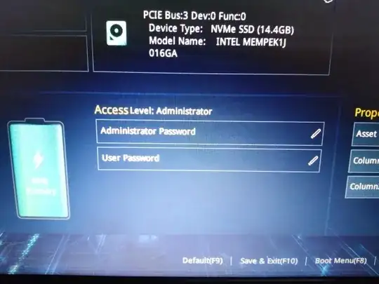

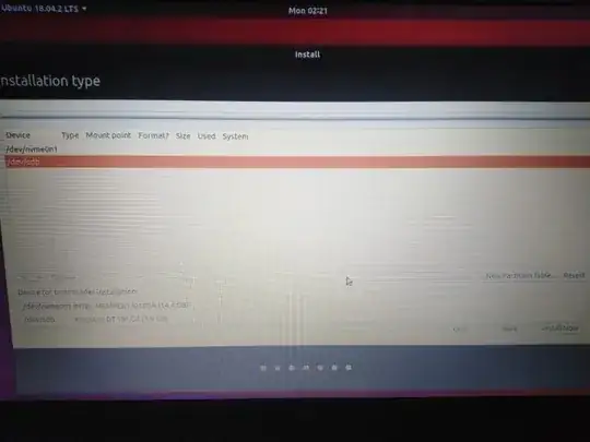

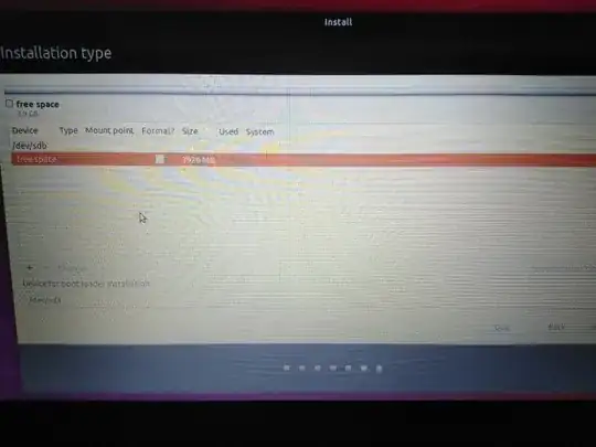

  • This is what happens when I restart my laptop and I try to install Ubuntu from my Kingston USB. It doesn't show the HDD, and it only shows my 4GB USB. This happens in the option "Try Ubuntu without installing" and in the option "Install Ubuntu" directly.
    Screenshot 1 Screenshot 2

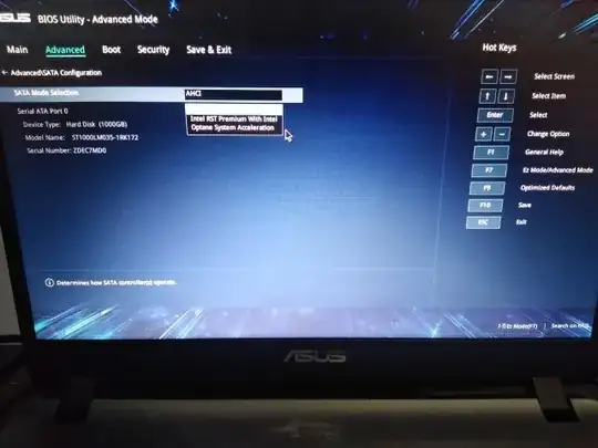

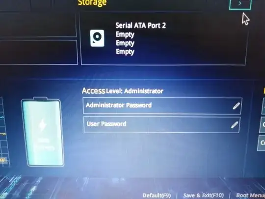

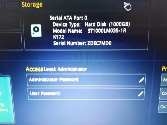

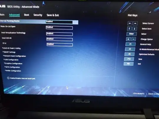

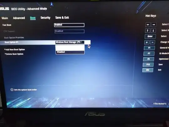

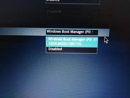

  • These are some things that appear in the BIOS configuration, like the option to change the SATA Mode Selection. Here I change the SATA Mode Selection from "Intel RST Premium With Intel Optane System Acceleration" to AHCI. Here are some photos of the SATA ports and the Boot option. But I have only changed the SATA Mode Selection.
    enter image description here enter image description here enter image description here enter image description here enter image description here enter image description here enter image description here enter image description here

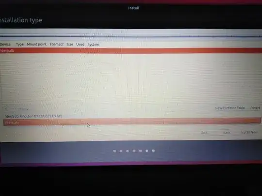

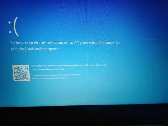

  • After changing the SATA Mode Selection, if I try to start my laptop with Windows 10, it gives me an error, and at the moment of trying to install Ubuntu, it shows the USB and also shows my 16gb Intel Optane. But it still doesn't show the HDD.

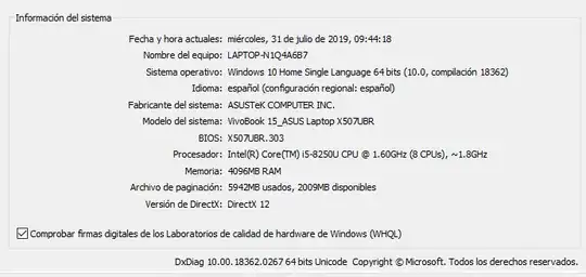

  • Here is a picture with my laptop specs and the website where I have bought the laptop.

The main problem is with detecting an Intel Optain hard disk which is not supported with generic drivers. Reinstallation of OS is required to change SATA mode. If you don't want to reinstall the whole OS this may be a workaround. You may try to enable AHCI SATA mode for Windows, then try to install other OS(ubuntu in your case). So GRUB will be able to create a boot entry for both OS by the end of the installation. After finishing the installation doesn't Forget to disable AHCI mode from BIOS setting otherwise it will result in a Blue screen error as in your case.
