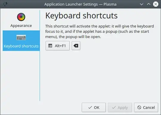

As discussed in an older question, if you have mapped it to something else, setting the shortcut key to Alt-F1 automatically enables the super key as a shortcut to open the application launcher. Here it is for kickoff (a.k.a. Application Launcher):
Application Launcher Settings, Keyboard shortcuts

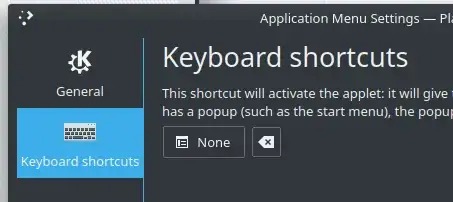

and here it is for kicker (a.k.a. Application Menu):
Application Menu Settings, Keyboard shortcuts
I have verified that this works for both on my machine running 18.04. It looks like you are using kicker, so you should be able to enable this behavior on your machine.

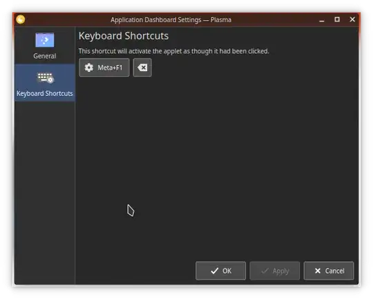

'Application Dashboard Settings ― Plasma' window
In KDE 5.18 set Meta+F1 as shortcut (Meta key means Windows key)
after it work on just meta keypress
