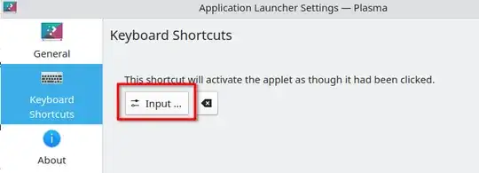

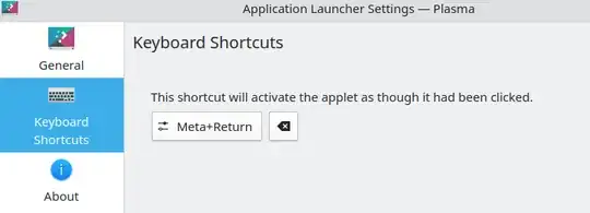

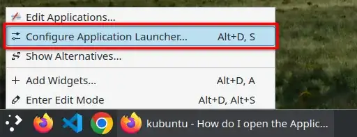

For me, the keyboard shortcut Windows + Enter worked (Kubuntu: 22.04/KDE Plasma: 5.24.6).
Steps:
  1. Right click on Application Launcher icon, select Configure Application Launcher.
  1. Go to Keyboard Shortcuts tab and click on Input ... button.
  1. Hit Windows + Enter keys on the keyboard.
(Windows = Meta = Super = same key.
Enter = Return = same key)
  1. It should look like this
  1. Finally, click on Ok to save the configuration and test.

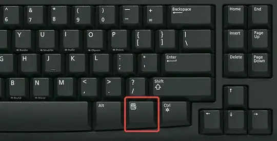

This simple solution don't use the Meta key but you can use only the Menu key for the shortcut.
The Menu key
