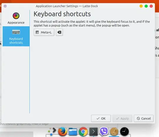

enter image description hereI want to open latte dock using only super key. Is there any way?

According to the FAQ page of the project on GitHub, there are two ways to do this.
You can either edit ~/.config/kwinrc and add
[ModifierOnlyShortcuts]
Meta=org.kde.lattedock,/Latte,org.kde.LatteDock,activateLauncherMenu
or run the following commands in terminal
kwriteconfig5 --file ~/.config/kwinrc --group ModifierOnlyShortcuts --key Meta "org.kde.lattedock,/Latte,org.kde.LatteDock,activateLauncherMenu"
then, in either case, reload KWin:
qdbus org.kde.KWin /KWin reconfigure
