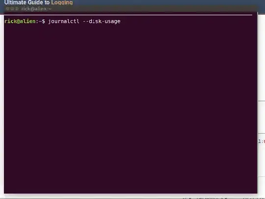

My journalctl is keeping over 300 MB of logs as revealed by journalctl --disk-usage. Everything appears to be in order when I run journalctl --verify:
$ journalctl --disk-usage
Archived and active journals take up 328.0M on disk.

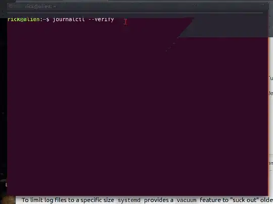

$ journalctl --verify PASS: /var/log/journal/d7b25a27fe064cadb75a2f2f6ca7764e/system.journal
PASS: /var/log/journal/d7b25a27fe064cadb75a2f2f6ca7764e/user-65534.journal PASS: /var/log/journal/d7b25a27fe064cadb75a2f2f6ca7764e/system@02f1aae76e32467390ab88ba03ae559e-0000000000000001-00056515dbdcd67e.journal PASS: /var/log/journal/d7b25a27fe064cadb75a2f2f6ca7764e/user-1000.journal PASS: /var/log/journal/d7b25a27fe064cadb75a2f2f6ca7764e/user-65534@9838f64d6ee047bebec9d30d329064d4-00000000000005bb-00056515dbfe8d9d.journal

Disk Space saved
The journalctl size is reduced substantially:
Archived and active journals take up 136.0M on disk.
Size has dropped from 312 MB to 136 MB a savings of 176 MB and 64 MB more than expected. This is probably a one time anomaly due to an extraordinary large single log file. I'll revise this answer after a month if new info arises.

Performance improved
The time to verify journalctl integrity is noticeably quicker:
Time has reduced from 10 seconds down to 4 seconds.
