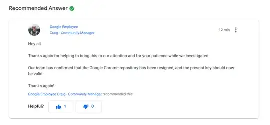

the problem was solved by Google Abr 12/2019 (Only Google Chrome. Tested in Ubuntu 18.04.x)
enter image description here There's nothing to do. The repository has already been signed

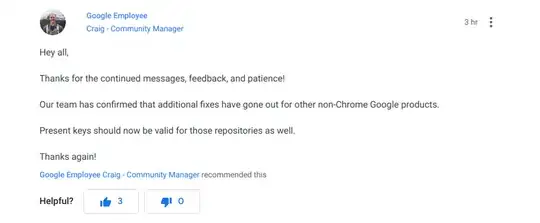

Update apr 19/2019:
Google Team has confirmed that additional fixes have gone out for other non-Chrome Google products
source: https://support.google.com/chrome/thread/4032170

Looks like, as @DooMMasteR said, Google let signing cert expire for their Linux repositories, which due date was April 12th. @yareckon explained that this apt security error is working as expected to prevent badly signed software being installed.
9 hours after the issue was posted, Google fixed certs transparently for the users using Google Chrome repo. The error stopped after they renewed the certs, progressively also on the rest of Google owned repos (Google Earth, Google Music Manager...).
No action is needed (and recommended) from users side, just waiting for the repos in use to be signed with renewed keys.
