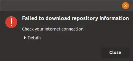

but it shows some errors:
Error message
Error message details:
E:The repository 'https://dl.winehq.org/wine-builds/ubuntu ubuntu Release' does not have a Release file.,
W:Updating from such a repository can't be done securely, and is therefore disabled by default.,
W:See apt-secure(8) manpage for repository creation and user configuration details.,
W:An error occurred during the signature verification. The repository is not updated and the previous index files will be used.

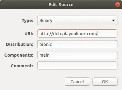

After looking at the repository information for bionic availabe on official site, it looks like you added wrong repository (with extra "ubuntu"). Modify the repository you've added using "Edit" button after clicking on repository in Software and Updates→Other Software.
After that remove "ubuntu" from "URI" so that it looks like:
Now open a terminal and run:

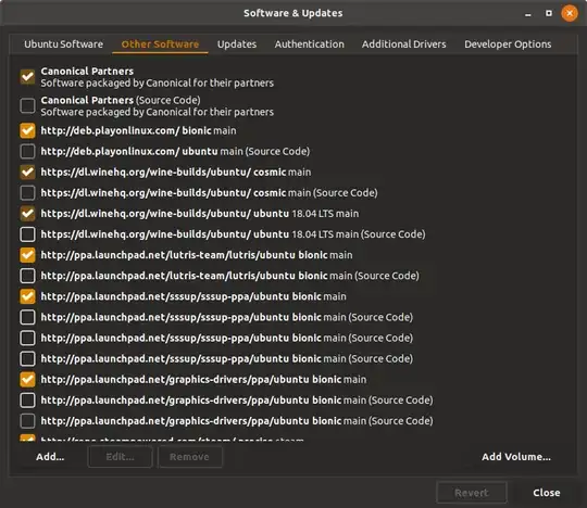

  1. For https://dl.winehq.org/wine-builds/ubuntu ubuntu Release:
    It seems this repository information is wrong. Look at the entry number 6 and 7 in your first screenshot. Repositories don't include version number, i.e. "18.04 LTS" but rather their respective codenames, i.e. "bionic". So, it's better to delete those entries. Also, according to your question you are using bionic but in your first screenshot it seems you've added repository information of cosmic. So, it's better to edit them and replace "cosmic" with "bionic". Otherwise, dependency issues might take place.

  3. For http://ppa.launchpad.net/sssup/sssup-ppa/ubuntu bionic Release:
    This repository was last updated for Natty (11.04) way back in February 2011. So, it's better to delete it. It's 11th entry in first screenshot.

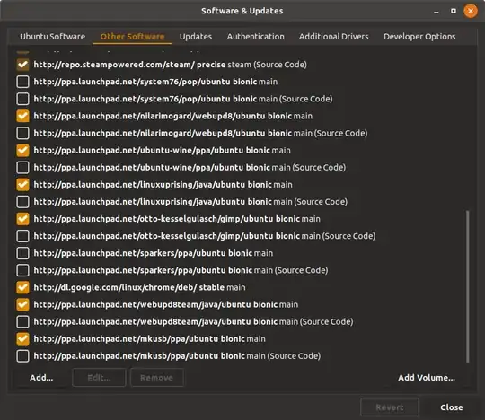

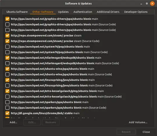

  4. For http://ppa.launchpad.net/ubuntu-wine/ppa/ubuntu bionic Release:
    This repository was last updated for Xenial (11.04) way back in 2017. So, it's better to delete it. Precisely it's on 10th place in Screenshot 2.
Tips:
  • I see there are many repositories unchecked. So I assume you don't use them. Try to delete all useless repositories so that less error happens and your other software tab become less cluttered.
