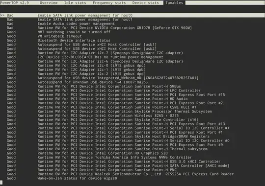

  3. I always have four tunables with "Bad" state, one of them is the Nvidia card that if I turn it into "Good" state the laptop save a lot of battery, so I do it each time I go on Battery mode. (I always use intel gpu)
top tunables

From this Q&A: PowerTop showing BAD status in SATA Link and PCI Device:
Whether the Good (lower power usage) or Bad (maybe higher performance) settings or a specific combination of those are more suitable for you depends on whether you need long battery life or high performance more. The decision is up to you.
To force all powerTOP settings to "good" when on battery you can use:
sudo powertop --auto-tune
