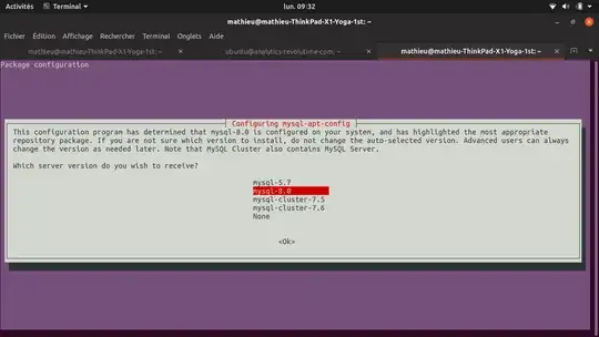

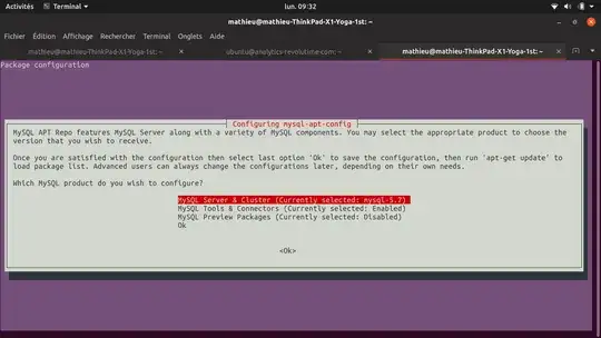

My problem :

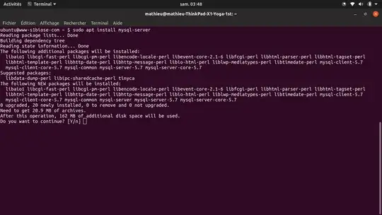

  1. I install MySQL with the command :
    $ sudo apt update
    $ sudo apt install mysql-server
When I do step 5, it installs MySQL 5.7 why does not it install version 8 ?
Kulfy
  • 18,154
fgtr
  • 83
18
Basically mysql-apt-config_0.8.12-1_all.deb is a package which adds MySQL's repository and key. It seems while installing this package you made wrong choices somewhere. You can do what that deb package do manually.
