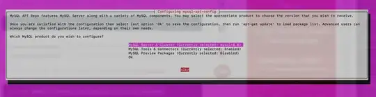

This give me a UI which looks correct:
first step of dpkg

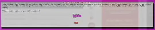

Leading to this selection:
second step of dpkg
When I select OK on THIS option, I am sent back to the first screenshot. Then that takes me to the 2nd. I am now in an infinite loop. When I hit escape, I get the following message:
