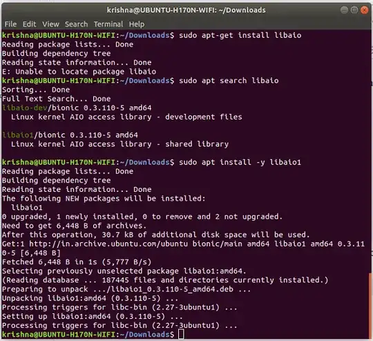

You may need to install the libaio library if it is not already present on your system:
how to check if libaio is installed (quickly)
$ apt-cache policy libaio1
If it's installed, it will display the version installed, if it's not, it will display the lines of text. If it is installed then skip Install libaio and goto step-1.
Install libaio
$ sudo apt-get install libaio1 libaio-dev

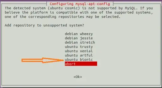

When you run the commands above, you should get a config prompt. Just select OK as shown in the image below.

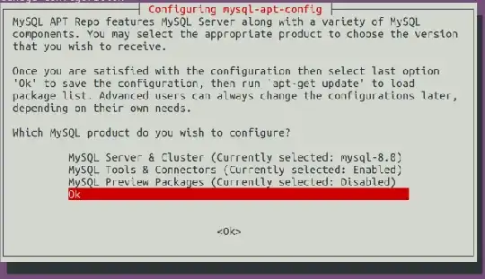

MySQL APT Repo features MySQL Server along with a variety of MySQL components. You may select the appropriate product to choose the version that you wish to receive.

When you run the commands above, you should get a config prompt. Just select OK as shown in the image below. But unfortunately, my observation was, MySQL was not supporting Cosmic Cuttlefish (Ubuntu 18.10), the installation was trying to abort, but you can select Ubuntu Bionic (18.04) and go ahead with installation. Use Up arrow and select ubuntu bionic (18.04) as shown in figure-1.
Navigational Tips:
a) Use or to position the cursor on your choice of System.
b) Hit Spacebar to mark your selection (Don't ignore this step).
c) Use Tab to navigate to OK button and press Return.
enter image description here Figure-2: Select ubuntu bionic (18.04) in the absence of ubuntu cosmic (18.10)
Figure-3: Select appropriate product

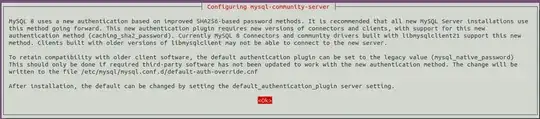

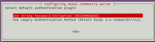

Also, you confirm whether you want to use the new password encryption feature. it’s recommended.
enter image description here Figure-6: password encryption feature
enter image description here Figure-7: Configuring mysql communuty server

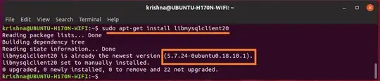

To install the shared client libraries:
$ sudo apt-get install libmysqlclient18
enter image description here Figure-8: install the shared client libraries

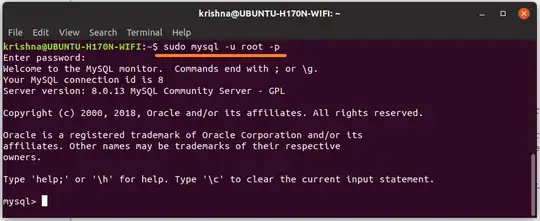

After that, MySQL should be installed, you can logon by running the commands:
$ sudo mysql -u root -p
You should see MySQL welcome screen shown below:
enter image description here Figure-9: Login into mysql

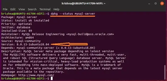

$ dpkg --status mysql-server            # Check the details of a package
enter image description here Figure-11: Status of mysql server
The status of server is shown in the above figure-11.

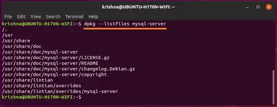

$ dpkg --listfiles mysql-server     # List the installed files of a package
enter image description here Figure-12: List the installed files of the package

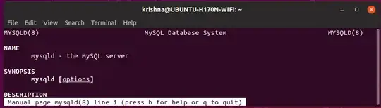

$ man mysqld // Read the manual enter image description here Figure-15: Read the manual for MySQL server daemon

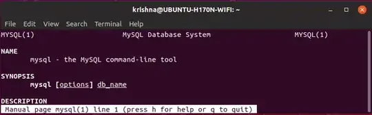

As seen from the above output, the MySQL command-line client mysql and utilities such as mysqladmin and mysqldump are located at /usr/bin (Application Software Binaries).
$ man mysql // Read the manual
enter image description here Figure-18: Read the manual for MySQL Command line tool

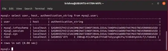

$ mysql -u root -p          # Enter the password for the root user you have set in Step 1
mysql> select user, host, authentication_string from mysql.user;
enter image description here Figure-20: Host and Authentication_string information for various users

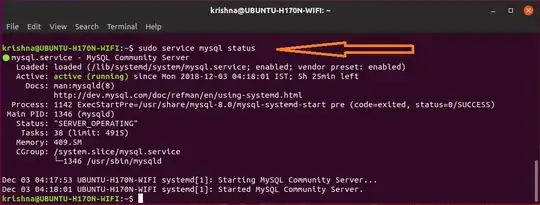

Step 7: Check Status of MySQL.
$ sudo service mysql status     # Show the status
enter image description here Figure-21: Status information of Mysql Server Process.
