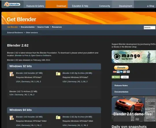

1. Get Blender
Open your browser and go to http://www.blender.org/download/get-blender/ . Download the appropriate version for your computer, 32-bit or 64-bit. If you don't know whether your computer is 32-bit or 64-bit, open a terminal (Ctrl+Alt+T) and run the following command :
uname -m
The Blender website showcasing the different Blender downloads available.

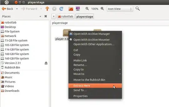

2. Extract Blender
Open Blender in your downloads folder, right-click on the file you downloaded and click "Extract Here". Once it finishes extracting, move the folder containing Blender to your Home Folder and rename it "blender" for ease of moving it later. enter image description here

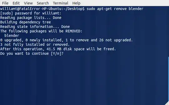

3. Uninstall the current version of Blender
Open a terminal by pressing Ctrl+Alt+T. Type this command set: sudo apt-get remove blender . enter image description here

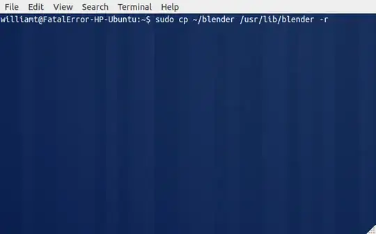

4. Copy the Blender files to where they need to go
Open a terminal. Type ls to see what files are in your home directory. There should be a folder called "blender". If there is, run the following command. If not, rename the folder and try again. If there's no folder at all, go back to step 2. Command:
sudo cp ~/blender /usr/lib/blender -r
This will copy all the files in the blender folder to /usr/lib/blender. enter image description here

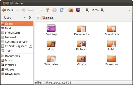

5. Verify that the files copied properly
Open the file browser by clicking the "Home Folder" icon in the launcher. Click "File System" on the left side, then open the folder usr, then lib blender. See if there's anything there. If there is, move on to the next step, if not, repeat the previous steps.

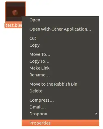

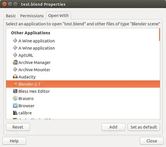

Associate .blend files with Blender
Finally, to associate .blend files with Blender, right-click on a .blend file and click on Properties
In that window click on the Open With tab and select Blender
Now, when you double-click a .blend file it'll open the file Blender.
