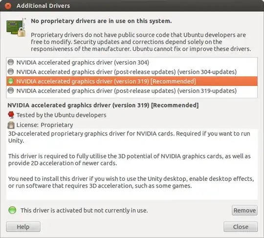

In order to install the recommended proprietary driver for your NVIDIA GeForce GT 640 graphics card, search in the Dash for Additional Drivers. Click on the Additional Drivers icon to open Additional Drivers. From the list of Nvidia drivers, select the driver that has [Recommended] after it. That's the graphics card driver that will give you the best performance. Click the Apply Changes button in the lower right corner to install the recommended Nvidia graphics card driver. Reboot to enable the Nvidia graphics card driver.

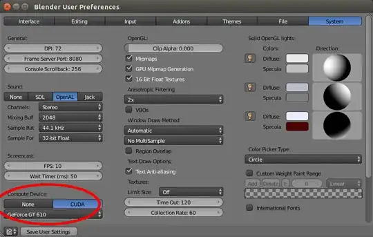

Here's how to enable CUDA with an NVIDIA graphics card. In Ubuntu 14.04 you need to install the nvidia-331 graphics driver or more recent in order to enable CUDA. You also need to install the NVIDIA CUDA runtime library. The Compute Unified Device Architecture (CUDA) enables NVIDIA graphics processing units (GPUs) to be used for massively parallel general purpose computation. Remove the existing proprietary NVIDIA driver and then open the terminal and type:
sudo apt-get install nvidia-331 libcudart5.5
Update: The updated above command for Ubuntu 16.04 is:
sudo apt install nvidia-375 libcudart7.5
Then open Blender and select File -> User Preferences and it will open a Blender User Preferences window. As you can see in the screenshot CUDA is enabled in Blender in Ubuntu 14.04 with an NVIDIA graphics card that is similar to yours.
