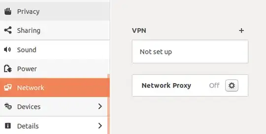

I have installed 18.04 Ubuntu Server. Then in terminal installed:
sudo apt-get install --no-install-recommends ubuntu-desktop
and when I now log into the desktop gui, my network shows as unmanaged at the top right, and in settings I do not get any wired settings options, why is this? enter image description here

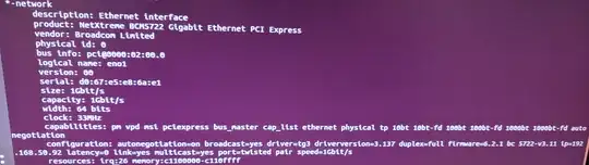

I ran:
sudo lshw -c net
and had to take a picture of the results for the moment: enter image description here

I had this same issue which seems to be an Ubuntu NetworkManager bug. I was able to solve my problem by adding a missing config file and then restarting the NetworkManager as follows:
sudo touch /etc/NetworkManager/conf.d/10-globally-managed-devices.conf
sudo systemctl restart NetworkManager
This thread lead me to this solution, which I am posting here in case it helps you. Credit to skizo for finding something that worked.
