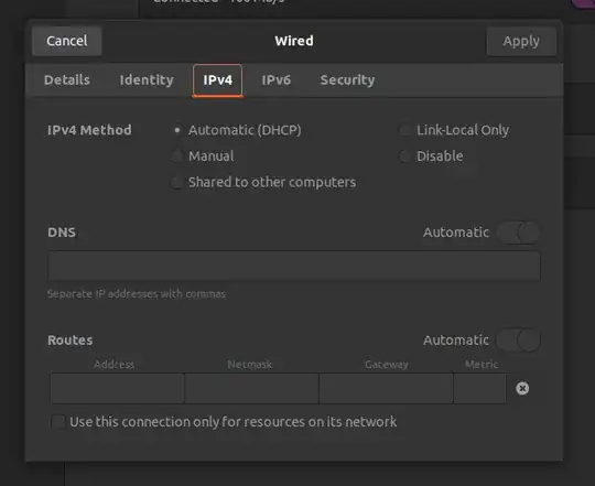

and sudo lshw -C network yielded *-network DISABLED. Then I tried to use that guide (section 'Static IP Address Assignment'). I created /etc/netplan/99_config.yaml, pasted the necessary code, run sudo netplan apply. Nothing changed except that I STOPPED SEEING wired connections in network settings... I tried the answer from here, and the 'Wired' section returned. But I can't change anything (for example, I can't pick 'Manual' option).
Screenshot
So, the questions are: how can I return the ability of changing it (in order to follow one more guide), or is there any other solution that will succeed in setting static ip address?...

Serg
  • 808
Pick ONE of the following two configurations...
Server installation with static IP...
Delete /etc/netplan/01-network-manager-all.yaml
Delete /etc/netplan/50-cloud-init.yaml
Edit /etc/netplan/99_config.yaml to look EXACTLY like this...
Note: regarding 192.168.0.116, make sure this address is outside of the DHCP range set in your router, and is not already used elsewhere.
Note: For DNS nameservers, settle on servers from one source... Google, Cloudflare, OpenDNS, etc. (3 max).
network:
  version: 2
  renderer: networkd
  ethernets:
    enp9s0:
      addresses: [192.168.0.116/24]
      gateway4: 192.168.0.1
      nameservers:
        addresses: [192.168.0.1, 8.8.8.8]
      optional: true
sudo netplan generate
sudo netplan apply
reboot
Desktop installation with static IP...
Delete /etc/netplan/99_config.yaml
Edit /etc/netplan/01-network-manager-all.yaml to look EXACTLY like this...
Note: Use the NetworkManager GUI to setup your static IP for "Wired Connection".
# Let NetworkManager manage all devices on this system
network:
  version: 2
  renderer: NetworkManager
sudo netplan apply
reboot
Note: See https://netplan.io/examples/ for examples and design info about netplan.
