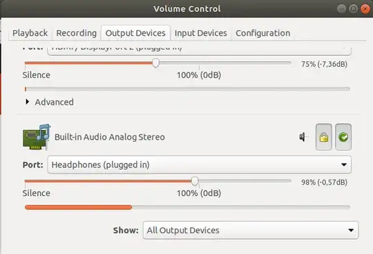

When I check out my sound output in pulseaudio I can see that my pc is detecting sound and trying to channel it out through my headphones, but there is no sound. Btw this is working perfectly fine in windows.
pavucontrol screenshot

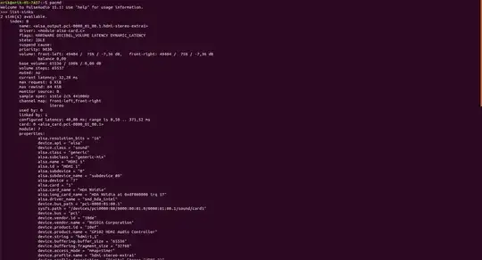

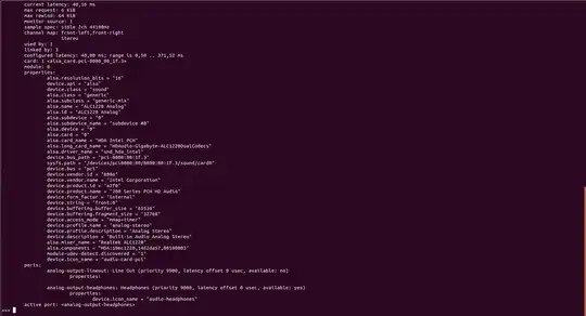

I also tried pacmd:
pacmd output (part 1)
pacmd output (part 2)
