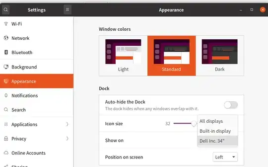

In Ubuntu 20.04 Focal Fossa, there's a simple setting you can configure in Appearance -> Dock -> Show on:
Change Dock settings in Ubuntu 20 Focal Fossa

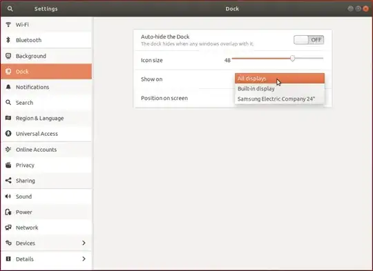

You can get the sidebar back to your primary screen by doing the following.
  1. Open Settings.
  2. Go to Dock.
  3. On the section Show on, choose the screen you want to display the Dock in.
An example (Ubuntu 18.04):
