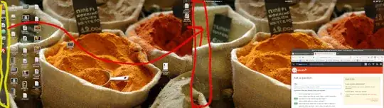

I am using two screens. The menu (Ubuntu dock) is shown at the left screen. I would like to have it on the right screen:
Changing the right monitor as primary screen does not help. Only the top bar is now shown at the right monitor and on the left monitor is a gap between the menu at the top.

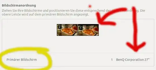

One has to set the right screen as primary screen:

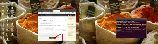

The only reason why I didn't see the menu on the right screen immediately, is because one needs to restart the PC or to log off & log in again. Now it works:
